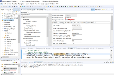

DanNguyenDuy
Hello @alice_th,
Please provide the name of the S32DS versions you are using.
And what are the FreeRTOS package's name and the S32K1 package's name you are using?
Dan
9,864 Views
alice_th
@DanNguyenDuy
S32 Design Studio for ARM
Version: 2.2
Build id: 200116
Copyright Freescale Semiconductor 2016. All rights reserved.
Copyright 2017-2020 NXP
9,862 Views

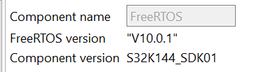

I can't find out the link to download the FreeRTOS 10.0.1 version on the NXP.com
Maybe this version is too old. Could you update to use FreeRTOS 10.4.6 (the latest version) instead of 10.0.1 version? If not, please send me the link to download FreeRTOS 10.0.1 version and the SDK package you are using.

sdk is too big, can't attached, only support 25M
below is what we have
C:\NXP\S32DS_ARM_v2.2\S32DS\software\S32SDK_S32K1xx_RTM_3.0.0
9,833 Views
alice_th
@DanNguyenDuy
all the sdk and rtos is auto download with s32ds tools
9,806 Views

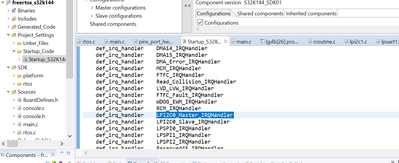

how install it, i see LPI2C0_Master_IRQHandler already in start.S file
9,779 Views

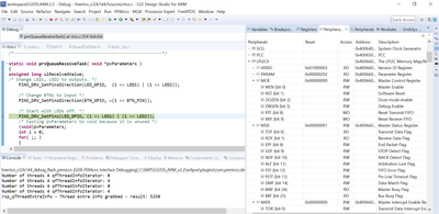

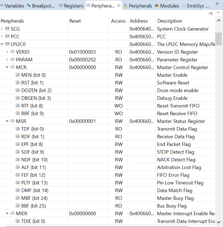

DanNguyenDuy

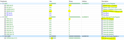

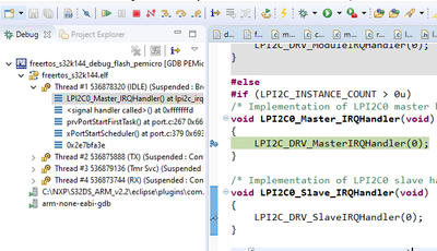

Hi @alice_th,
If you have an interrupt function in the startup file then you only need to enable LPI2C0_Master_IRQn in your code.
You should put a breakpoint in the LPI2C0_Master_IRQHandler to check whether you can jump into this function or not.
If the LPI2C0 interrupt didn't occur, you should check whether the bits are configured correctly as the below or not.
If not, please modify your configuration to enable the above bits.
Dan

9,727 Views

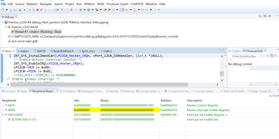

alice_th
@DanNguyenDuy
even i add installHandler INT_SYS_EnableIRQ(LPI2C0_Master_IRQn); or set MCR MIER ISER register,
but still can't enter LPI2C_DRV_SlaveIRQHandler(0);  what is problem ? did you run my project and enther i2c irq ?
/* Install Button interrupt handler */
    INT_SYS_InstallHandler(LPI2C0_Master_IRQn, vPort_i2C0_ISRHandler, (isr_t *)NULL);
    /* Enable Button interrupt handler */
    //LPI2C0->MCR |= 0x09;
    //LPI2C0->MIER |= 0x01;
    //S32_NVIC->ISER[0] |= 0x01000000;
static void prvSetupHardware( void )
int i = 1;
lpi2c_master_state_t lpi2c1MasterState;
    /* Initialize and configure clocks
     *  -   Setup system clocks, dividers
     *  -   see clock manager component for more details
    CLOCK_SYS_Init(g_clockManConfigsArr, CLOCK_MANAGER_CONFIG_CNT,
                   g_clockManCallbacksArr, CLOCK_MANAGER_CALLBACK_CNT);
    CLOCK_SYS_UpdateConfiguration(0U, CLOCK_MANAGER_POLICY_AGREEMENT);
     PINS_DRV_Init(NUM_OF_CONFIGURED_PINS, g_pin_mux_InitConfigArr);
LPUART_DRV_Init(INST_LPUART1, &lpuart1_State, &lpuart1_InitConfig0);
LPI2C_DRV_MasterInit(INST_LPI2C1, &lpi2c1_MasterConfig0,&lpi2c1MasterState);
    boardSetup();
  //  LPUART_DRV_Init(INST_LPUART1, &lpuart1_State, &lpuart1_InitConfig0);
    AMS_LOG("prvSetupHardware=%d\n",i);
    INT_SYS_InstallHandler(BTN_PORT_IRQn, vPort_C_ISRHandler, (isr_t *)NULL);
    INT_SYS_EnableIRQ(BTN_PORT_IRQn);
/* Enable global interrupt */
    INT_SYS_EnableIRQGlobal();
    /* The interrupt calls an interrupt safe API function - so its priority must
    be equal to or lower than configLIBRARY_MAX_SYSCALL_INTERRUPT_PRIORITY. */
    INT_SYS_SetPriority( BTN_PORT_IRQn, configLIBRARY_MAX_SYSCALL_INTERRUPT_PRIORITY );
INT_SYS_SetPriority( LPI2C0_Master_IRQn, configLIBRARY_MAX_SYSCALL_INTERRUPT_PRIORITY + 1 );
9,722 Views
DanNguyenDuy
Hi @alice_th,
Please double-click into those bits and show me the values of them.
Second, I can't open your configuration to check it because something wrong (I don't know) and so, I enabled the bits in previous comment and it ran OK.
Dan

alice_th
@DanNguyenDuy
9,718 Views
alice_th
@DanNguyenDuy
even the register is same as you
it will block it
