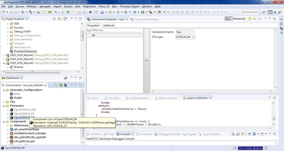

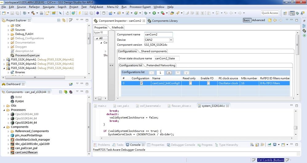

s32k144 64 pin 20mhz xtal the can2 can't work,
use cal_pal_s32k144
change the xtal 20mhz &change 64pin the can0,can 2 not work
why?

so, you have got some own board where 64pin MCU is mounted and it uses 20MHz crystal?
Then what is not working in fact? Please be more specific. The MCU does not start at all. Or just CAN module issue is seen? For example CAN module cannot be initialized, does not transmit or receive or ....?

i have s32k144 board the xtal was 20mhz.
the spi work and the can 0,can2 not work but the mcu are running.
can driver  init passed.
and sent can message only one time sent passed and the mcu can0tx,can0rx no any signal
and 2nd send can message the can status always busy status.
mean no any signal at s32k144 pin PTE5,PTE4 or can2 PTB12,PTB13,
the 20mhz xtal work narmal

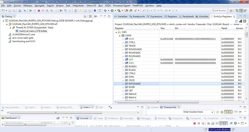

Also check value of the ESR1 and ECR registers.

ESR1.jpgESR1 and ECR registers are 0x00.why?

PetrS
if modules leaves Freeze mode, you should see SYNCH bit set, meaning module is synchronized to the bus.
If not most probably pin setting is wrong, or externally RX pin is held low. So this status you see when you connect TX to RX without transceiver? Did you measure pins by scope?
