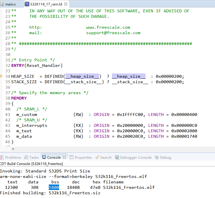

364713ca-ed28-4d46-9d1f-da82ceb8f2a1.png I set the configTOTAL_HEAP_SIZE = 4096 in freertosConfig.h ,the project can build successfully.if I set the configTOTAL_HEAP_SIZE = 8192,the project show error:S32k116_Freertos.elf section `.bss' will not fit in region `m_data_2'
region m_data_2 overflowed with stack and heap
section .stack VMA [20003600,200037ff] overlaps section .bss VMA [200020c0,200042a3]
region `m_data_2' overflowed by 0 bytes
when it is 8192 ,the ram used only almost 9 KB, less than the total ram space 16kB.why does it remind error,how to solve it?

Do you really use the RAM linker file that you posted or is it the Flash linker file?
Anyway, there is only 0x37FF of SRAM_U.
The heap is in m_data_2 memory area. So, if you need 8kB heap, you need at least 8kB (0x1FFF) of m_data_2.
But there is BSS and the stack in m_data_2 too.

Hi @Harold_zhou,
The error message mentioned m_data_2 which is in the *flash.ld linker file only.
So, you use the *flash.ld linker in the project not the *ram.ld
You can increase m_data_2 but only within the size of the actual SRAM_U as I mentioned.

it is ram link file,so I need change the m_data_2 in linker file named flash.ld
/* SRAM_U */
m_data (RW) : ORIGIN = 0x20000000, LENGTH = 0x000020C0
m_data_2 (RW) : ORIGIN = 0x200020C0, LENGTH = 0x00001740
