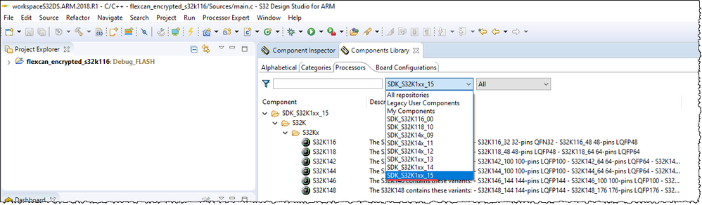

Robin_Shen
There is a simple way to change package, please refer: How to change package on S32DS Processor Expert
Different package will not impact the wake up function, please direct download that example and then change package to test.
Please first make sure the example works on your board.

Robin_Shen
Would you please try to use S32DS.ARM.2.2? That example is based on it.
If you have install "S32 Design Studio for ARM v2018.R1 Update 11 with S32 SDK S32K1xx SR 3.0.2(REV UP11)", you should be able to select SDK_S32K1xx_15.
Robin

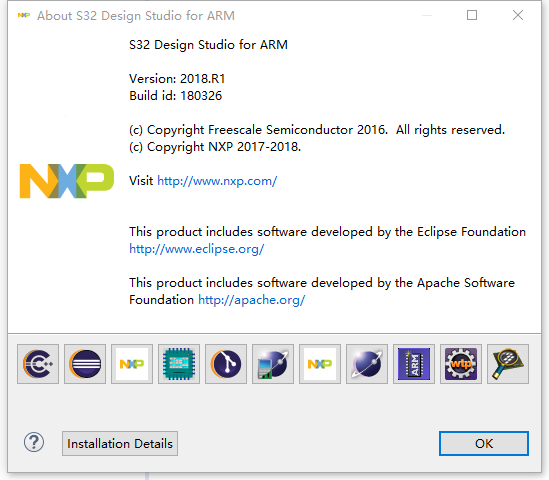

972276616
Hi Robin,
I have installed the v2018.R1 version, and have used the official website S32DS_ARM_v2018.R1_UP11.zip to update, do I need to select all items to update during the update process?
Zheng Yu
2,801件の閲覧回数
Robin_Shen
Please update the full S32DS_ARM_v2018.R1_UP11.zip.

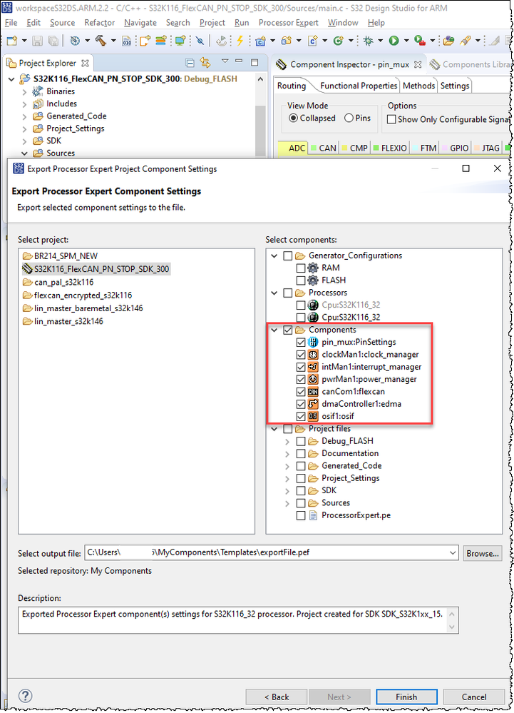

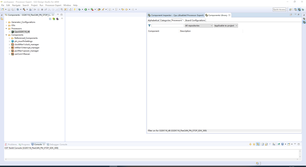

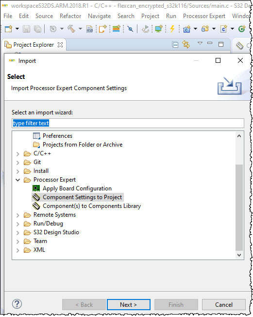

Robin_Shen
Maybe you can try to import "Component Settings to Project" to your S32DS.ARM.2018 project.
I have "Expert Processor Expert Component Settings", please check the attach file.
Robin
