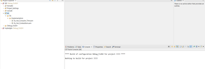

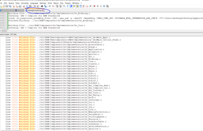

HELLO, When I Integrate ghs into s32ds ,and use the S32ds IDE to build the project, as you see, I have import the asm file, but the log show that the S32DS can not call the ghs to compiler the asm code, I do not KNOW why. I need some help.
Thank you.
in the build log, I can not see the asm file to be compiled.

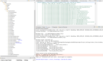

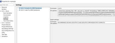

Thank you for responsing,  But I mean that the .asm file can not compiler, although I have already add it into source file,
but When I change the suffix from .asm to .s, then S32DS can compiler it.

As the error express you have unresolved symbols:.
