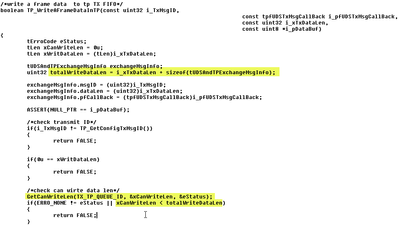

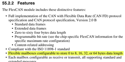

In case of CAN FD mode, length of data is limited to 64 bytes:
And the length is checked like this:
As you can see, messageinfo will also occupy a couple of bytes.
So, you need to follow this limitation.
