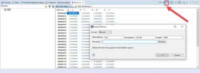

Using a modified version of the S32 bootloader in AN12218 and I've got 2 SREC files that the data is identical except the record alignment. One loads and boots fine, the other ends up causing an exception after attempting to jump into the app.
Srecord Tools (http://srecord.sourceforge.net/) srec_cmp states that they are the "same". The one that fails is generated using S32 Design Studio with the --srec-len 32 option, while the other is the same file but run through the Srecord Tools srec_cat tool with the -Output_Block_Size 32 option.
How do I compare the flash contents to an SREC file to see what is different?

If you use S32 Design Studio, the memory content can be exported to s-record file in the memory tab:

lukaszadrapa
we got a report about weakness of the s-record parser short time ago:
https://community.nxp.com/t5/S32-Design-Studio/Why-does-the-AN12218SW-bootloader-fails-to-parse-the-...
I already sent the report to responsible team and it will be either fixed or maybe they will add a note that it's necessary to convert the file to specific format when each s-record format has fixed length - and this is also the workaround I can recommend.

lukaszadrapa
