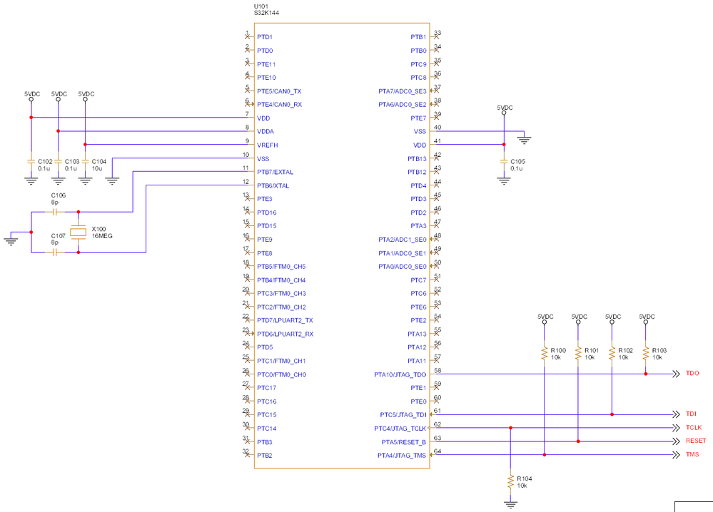

I made a minimal system board with s32k144. After I finished soldering the component and power the board on (no software flashed), I used an oscilloscope to watch the waveform of PTB6 and PTB7. There is no waveform, solely a constant dc voltage which is about 0.8V high.
Is it normal to have a constant dc voltage at these pins? I thought it should be a sine waveform. Please see the circuit below.

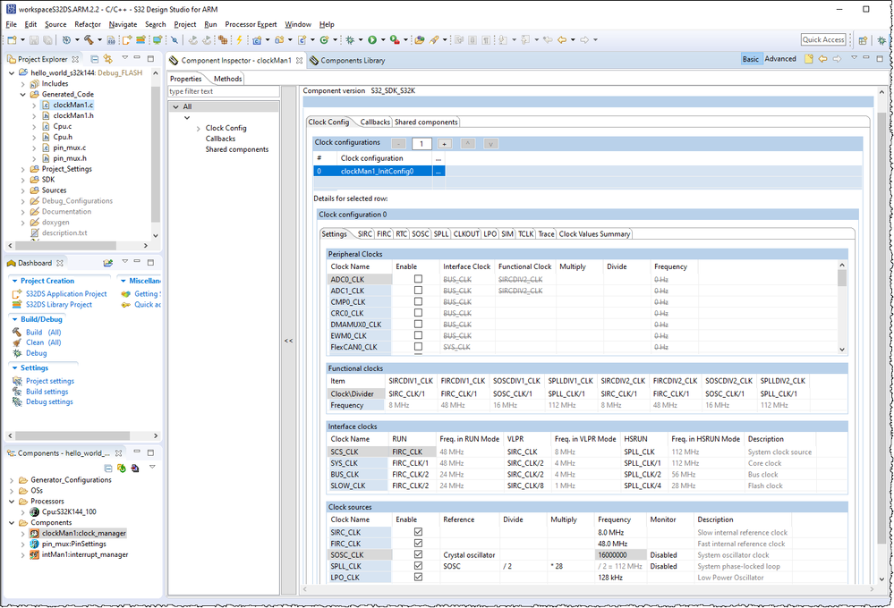

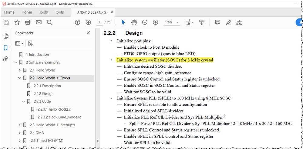

Robin_Shen
Hi ZZD,
The sine waveform is not generate by default. You need to initialize system oscillator (SOSC) first.
If Processor Expert is used, you can achieve it by configure SOSC in clock_manager.
