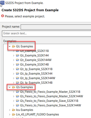

If you are just starting your development we recommend you to use our latest SW. You could follow the Get Software section of GS-S32M24XEVB, which uses the same RTD as the S32K1xx.
Such RTD provides you various examples, including for I2C and I2S for the main derivatives like K144, K118 and K144W.

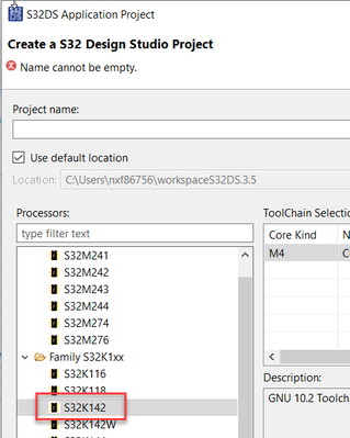

For K142 you will need to create a New S32DS Application Project and refer to available examples.
