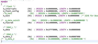

I have a bootloader binary file and want to merge with application project and load it as .elf/srec/bin file.
I found a solution here
https://community.nxp.com/t5/S32-Design-Studio/Compiling-multiple-projects-in-S32DS-IDE/m-p/705483
In this solution bootloader address in continuous from 0x0000_0000 to 0x0000_A000 and may not work with my bootloader memory layout.
But In my bootloader memory layout is like below
 interrupt is from 0x0000_0000 and Bootloader Application is from 0x1000_0000
Help me merge bootloader binary bin(with my configuration) with application project.

Hi @lukaszadrapa,
Will this method take care of different memory location of bootloader(bootloader's interrupt are from 0x0 to 0x400 and text from 0x10000000)??
2,607 Views
lukaszadrapa
This method doesn't care about the binary file content. It takes the content and put it to specified area, nothing else.
Notice that binary file is continuous image of raw data. If you have some data at 0x0 and then another data in data flash at 0x1000_0000, then the binary file will cover everything in this range including the huge gap between program and data flash. For this purpose, it would be better to have two bin files.
