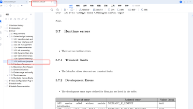

now,i want to erase/read/program the pflash with memacc, but i am confused about the example in rtd。so can i get the correct the example of the demo?
in the red provieded by the rtd ,the memacc is aboute to operarte the external flash;the meminfls is about to operate the pflash ,but according to the autiosar arthictule,the memacc can direcetly to earse/read/program the pflash.

Refer to RTD_MEMACC_UM.pdf that can be found in the installation directory of the RTD:
SW32K3_RTD_4.4_R21-11_3.0.0\eclipse\plugins\MemAcc_TS_T40D34M30I0R0\doc\
Section 3.2.1.1 Introduction.
Let me know if there is something unclear,
BR, Daniel

sorry,with the RTD 3.0.0 P07,in the mem_acc um,I can not find the section 3.2.11
please tell me how can i get the latest um

Could you please install the base version 3.0.0:
SW32K3_RTD4.4_R21-11_3.0.0_D2303.exe
Please note that version 3.0.0 P07 is just a patch of the base 3.0.0 release.
The up-to-date version is RTD 6.0.0 already.
Thank you

but in the nxp official website, i can not find the SW32K3_RTD4.4_R21-11_3.0.0_D2303
could you please give the accurate link

You should be able to access all the RTD releases through you NXP account or at this link:
https://www.nxp.com/webapp/swlicensing/sso/downloadSoftware.sp?catid=SW32K3-STDSW-D
Automotive SW - S32K3/S32M27x - Real-Time Drivers for Cortex-M
If you can't find RTD 3.0.0, use 5.0.0 or 6.0.0.
