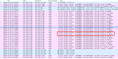

I developed a board with S32K344 and it can run the lwip demo project "lwip_s32k344" correctlly.I can ping the board from my PC.However, it works abnormally when I try to implement the demo code into my own project on the board.When I ping it from PC, the reply message sequence number is always smaller than the request message sequence number. That means the board does not reply the 1st request and it replies the following request with the one for previous request.

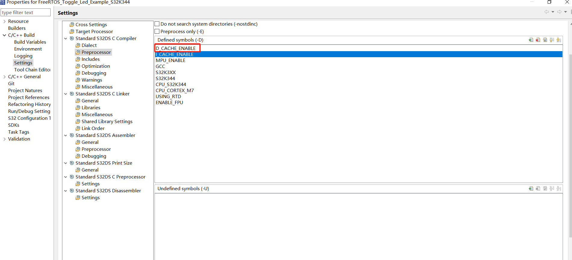

I find the problem is caused by different compiling settings between demo project and my project.My project has defined D_CACHE_ENABLE.Seems the D.CACHE is a specific feather of M7 core(CM3 and CM4 does not have it).I remove the definition of D_CACHE_ENABLE and project works well.

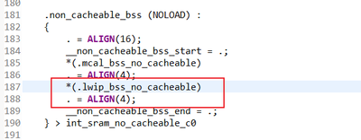

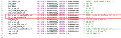

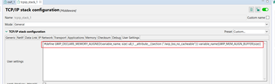

② Allocate the lwip heap from non-cacheable region. Thus the cache can keep enable, it's good. When use this way, you need to make below changes:
  a) Increase the non-cacheable region (decrease shareable region)  in linker file and add the lwip non-cacheable heap region for next use.
  b) Add lwip memory allocation macro in .mex tcpip component "user setting" page, thus it would be generated in lwipcfg.h, and to replace the default allocation way in "arch.h" which allocate memory from shareable region.
