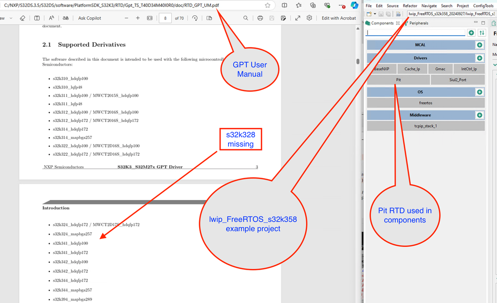

Our product is based on S32K328 where MCU directly connected to a switch through MII.
I am trying to follow the 'lwip_FreeRTOS_s32k358' example, but, running into the following issues.
Could you please suggest a way forward?
Question 1:
lwip_FreeRTOS_s32k358 example uses Pit componet (GPT).
But, PIT doesn't seem to support S32K328. Attached screenshot.
How can we modify the example program not to use PIT nor Phys?

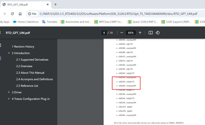

I see S32K328 listed in the GPT UM
regarding switch connection, Just be sure your MAC to MAC connection is correct.
The example does not require modification if same RMII connection is used, if not modify GMAC setting and pin config accordingly.
