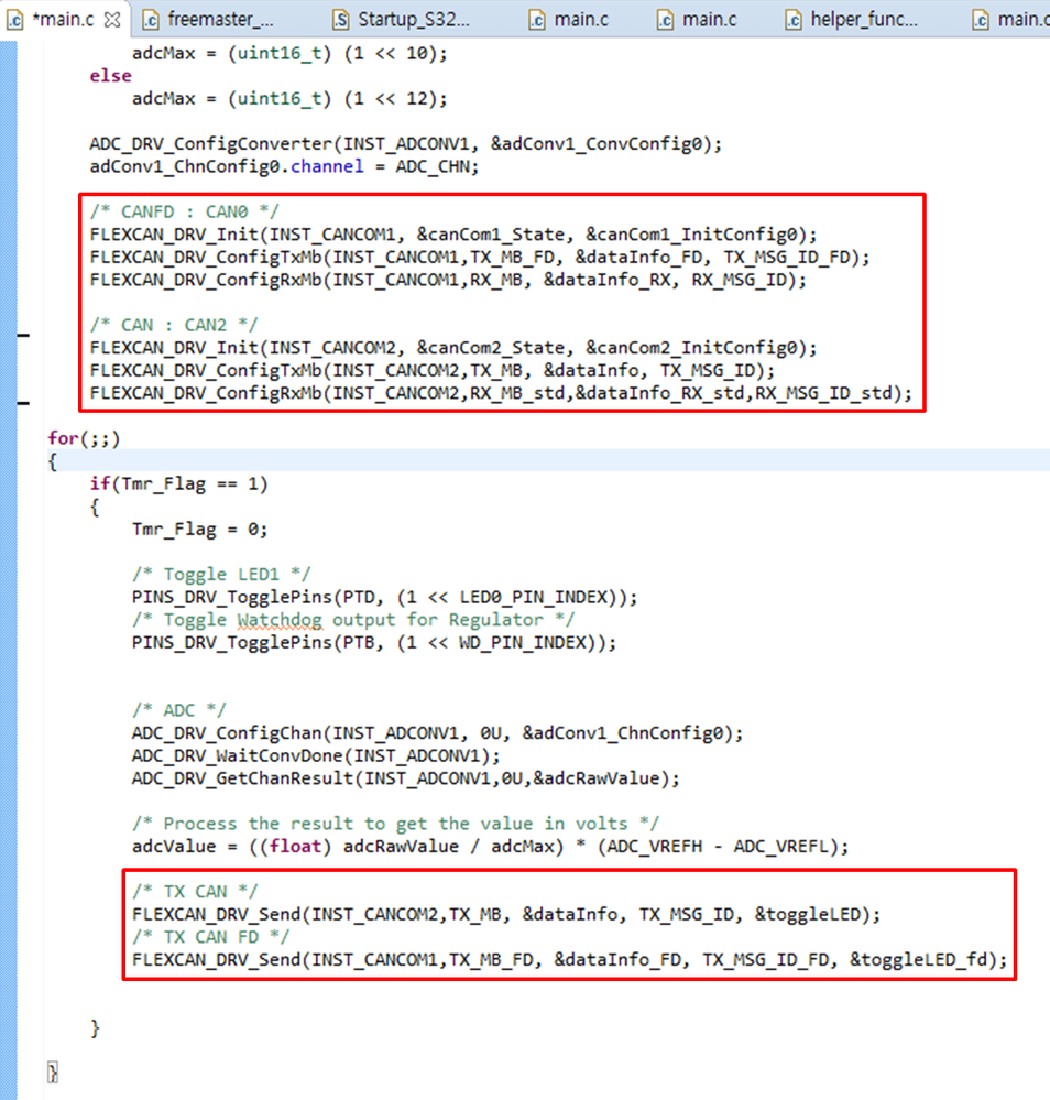

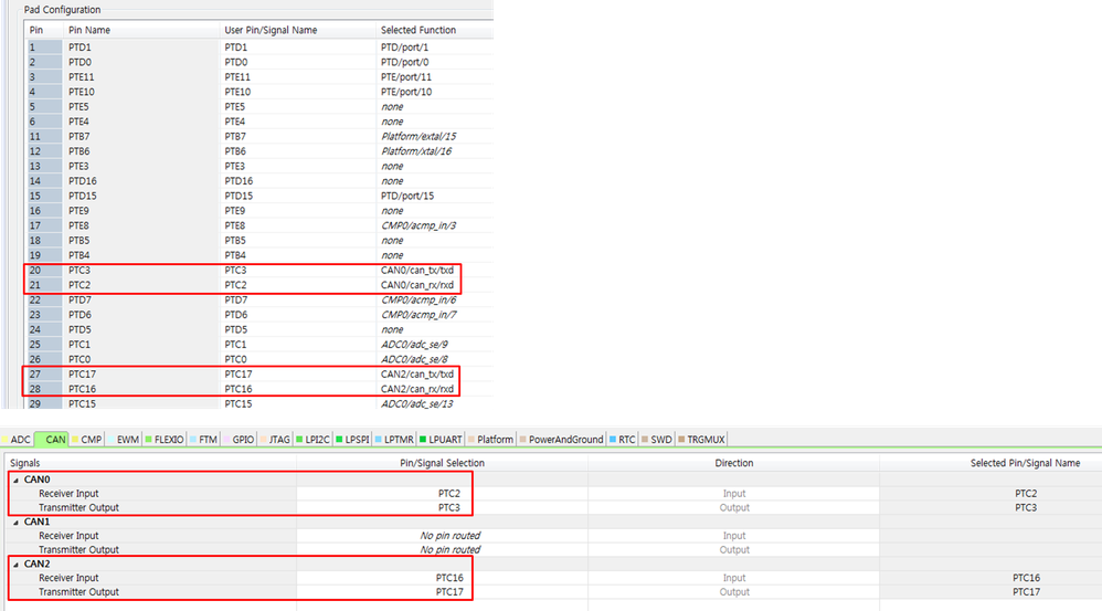

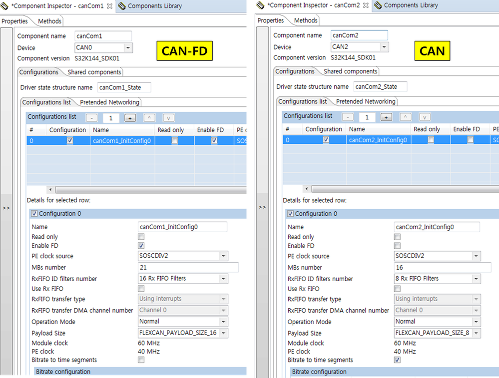

I am trying to send CAN 2 channel.
One channel is working correctly.(CAN-FD)
But the other channel is not working(CAN). No signal outputs on MCU TX pin and RX pin.
What should I check?
Please refer to followings
- MCU : S32K144(64pin)
- S32DS 2.0
Thank you.
