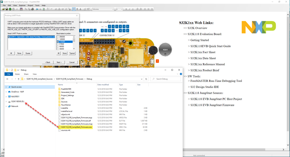

3. Installed S32DS IDE and built the example project. When trying to Run hte project on the board, got the below error

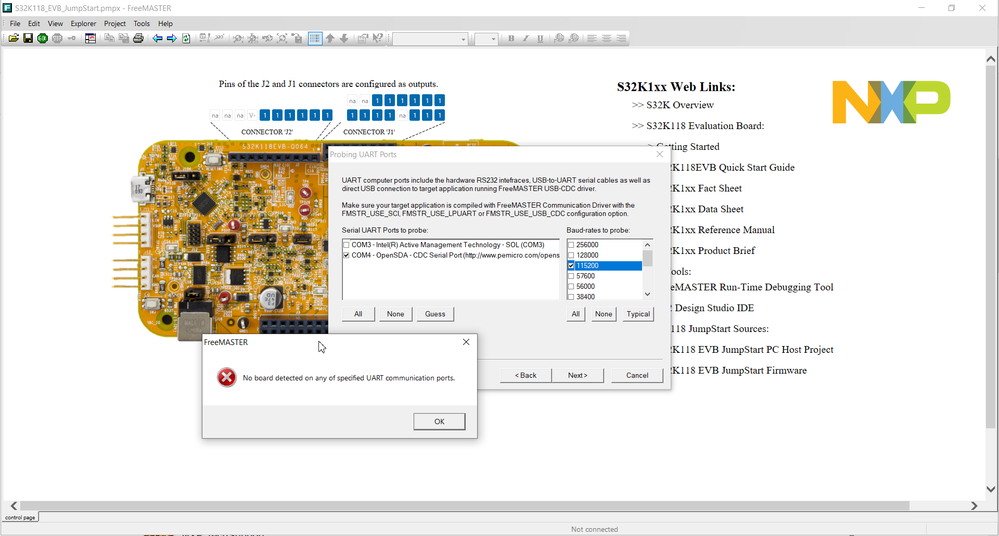

4. Installed freemaster and tried to connect to the eval kit and got below error.
Please let me know why am i facing this issue and how to resolve this asap.

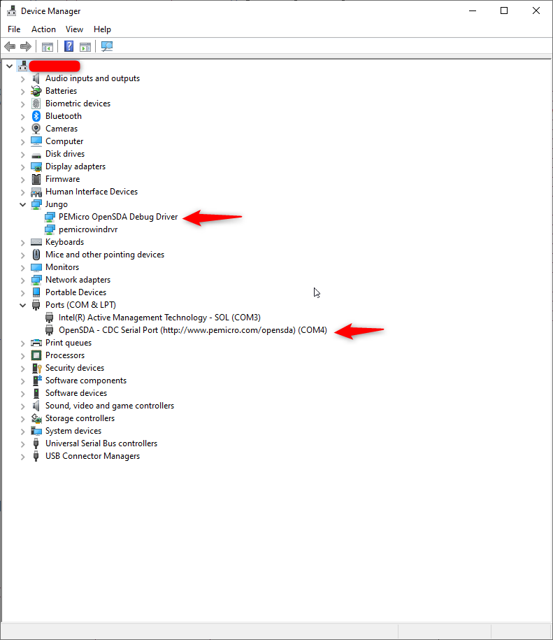

Dear @Robin_Shen ,
Please comment on Points 3 and 4 as to why either S32Ds or FreeMaster is not able to Connect to the eval kit.
Attaching my device manager screenshot confirming that i have installed right drivers.
DeviceManager_ScreenshotDeviceManager_Screenshot

Robin_Shen
Hi Aditya,
You can find the S32K118_EVB_JumpStart_Firmware.srec in this folder: S32K118_EVB_JumpStart_Sources\S32K118_EVB_JumpStart_Firmware\Debug
After drop this file into S32K118EVB, it should be able to run this demo.
If the S32K118_EVB_JumpStart_Firmware.srec works but the project did not work, then please check if the project generated correct codes and build\debug setting.
Robin

AdityaB
Hi Robin,
I had done the same before. Retired the same with the .srec shared by you. RBG lights not glowing in eval kit. Also in free master the same error as attached before is reappearing. i am using 115200 as baudrate.

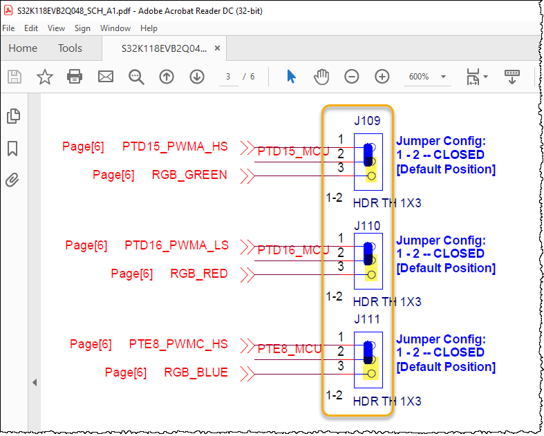

The default setting of J109\J110\J111 connect 1-2, but should be 2-3 in order connect the signals to GRB LEDs.

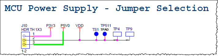

Try to connect 2-3 of J10, power the VDD of MCU by P5V0.

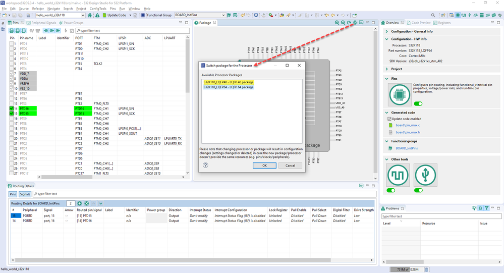

I didn't find other difference, so you can use:
S32 Design Studio for S32 Platform Version: 3.4
S32 Design Studio S32K1XX SDK RTM 4.0.2
Remember Switch package for the Processor and Update Codes.
