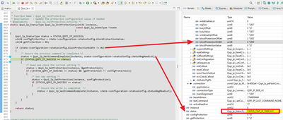

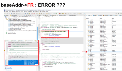

Hi Sir,
the QSPI sample code was timeout after called the "Initial Protection" as below.
please help us to check, thanks.
can we disable this protection function?
we had read this timeout issue.
https://community.nxp.com/t5/S32K/QSPI-FLASH-Init-time-out/m-p/1228072
  • SDK: S32DS 3.5 (Build id: 240529 (Update 12)), SDK 4.0.0
  • HW: S32K344 EVB, it was reworked all pins from ENET to QSPI.
  • FW: We used the example code as below.
thanks.

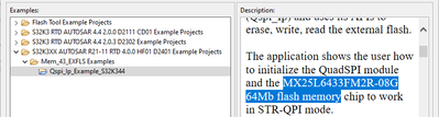

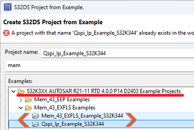

  • Trouble:
    • if I used the AutoSAR R21-11 on 344EVB, it still has the TIMEOUT ERROR.
    • But AutoSAR 4.4 was OK as above description P24, D2405.
    • we tested QSPI on S32K344 EVB and complete rework.
  • SDK version:
    • AutoSAR: R21-11, P14, D2403.
    • SDK: 3.5.13

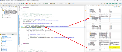

  • Test result

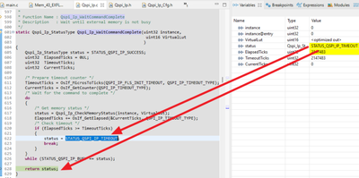

    • Status is Busy & timeout in Qspi_Ip_InitProtection()
    • Status is Busy & timeout in Qspi_Ip_WaitCommandComplete()
    • Status is Busy in Qspi_Ip_CheckMemoryStatus()
    • Status is Error in Qspi_Ip_ErrorCheck()

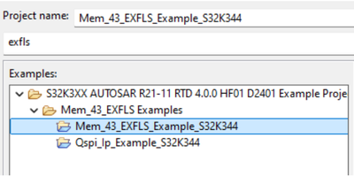

Jireh
Hi @VaneB
We changed the sample code to ExFls as below.
but it also had the same timeout problem when initial the protection.
BTW, it always Busy if get the memory status in protection initial.
and then it will be timeout after end of while loop.
why? I didn't change any config.

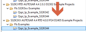

Jireh
Hi @VaneB ,
thanks,
we changed to this version and used D2405 sample code, it was working.
