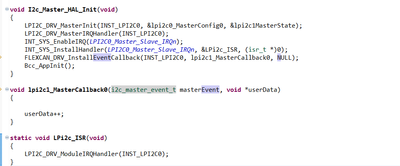

This is how i am doing init configuration

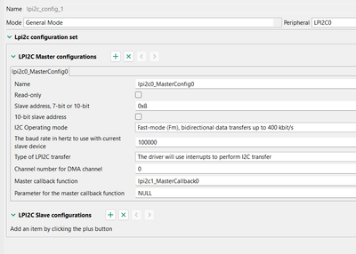

and these are my peripheral settings

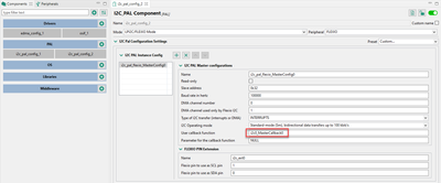

You can refer to the I2C PAL example from the SDK. The initialization for interrupts and callbacks is done by I2C_MasterInit/I2C_SlaveInit.
You can configure the master callback in the I2C_PAL component and test with a breakpoint:
Also, is there a reason you are using FlexCAN driver (FLEXCAN_DRV_InstallEventCallback) to install the callback? This may be why your code is not working.
