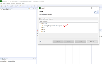

Open EBTresos and click File -> Import -> General -> Existing Projects
into Workspace

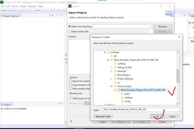

, select the template project McAl_template_project_dio_47811a_440_100. zip installation Path into which the Tresos project is imported.  when i click the somld , some error comes out .the details as below.
What causes this problem and how can I fix it, thanks.
Best regards.
Guofred

The problem is EB Tresos couldn't find the MCAL package. You need to install the MCAL package which correspond to the project you're using, by copy to the EB/tresos/plugins folder.
Nam
