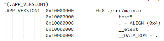

l want to initialize the memory 0x10000000-0x1000 0007 with {0x08,0x07,0x06,0x05,0x04,0x03,0x02,0x01}, I set
in   .c
 __attribute__ ((section(".APP_VERSION1"))) uint8_t test5[8]={0x08,0x07,0x06,0x05,0x04,0x03,0x02,0x01} ;
for(i=0;i<8;i++)   {sourceBuffer[i]=test5[i];}
I found from test5[0] to test5[7] and sourceBuffer[0] to sourceBuffer[7] is 0xff,who can tell me how to initialize it,thank you for you response.
in .ld
MEMORY
/* Flash */
m_interrupts (RX) : ORIGIN = 0x00000000, LENGTH = 0x00000400
m_flash_config (RX) : ORIGIN = 0x00000400, LENGTH = 0x00000010
m_text (RX) : ORIGIN = 0x00000410, LENGTH = 0x0007FBF0-0x8000
/* ccp_1 (RX : ORIGIN = 0x00042000, LENGTH = 0x00002000
name_1 (RX) : ORIGIN = 0x00044000, LENGTH = 0x00002000 */
ccp_1 (RW) : ORIGIN = 0x10000000, LENGTH = 0x00002000
name_1 (RW) : ORIGIN = 0x10002000, LENGTH = 0x00002000
/* SRAM_L */
m_data (RW) : ORIGIN = 0x1FFF8000, LENGTH = 0x00008000 /*//20K*/
/* my_data1 (1FFF8000 1FFF CFFFF )20K ( 1FFFD000 1FFFFFFF 8K )
my_data1 (RW) : ORIGIN = 0x1FFFd000, LENGTH = 0x00002000
/* SRAM_U */
m_data_2 (RW) : ORIGIN = 0x20000000, LENGTH = 0x00007000
SECTIONS
.APP_VERSION1 :
. = ALIGN(4);
KEEP (*(.APP_VERSION1))
. = ALIGN(4);
} > ccp_1

8,402件の閲覧回数
danielmartynek
The code is correct. It works for me at least.
What do you see in the Memory window?
And in the .map file?
Can you attach you project?

jinshuaixu
Contributor V
     Hi ,Daniel
    Today, l debug the code, l find use attribute to initialize memory is success, the reason that why the memory data became 0xff is that  l use "FLASH_DRV_DEFlashPartition" function ,it caused data_flash memory data is erased.
    so l think,l can use boot and APP code, boot code is used to initialize memory section ,app code is used to initialize dataflash memory data on using "attribute".
     whether my thought is right or wrong, please tell me, very thank you. you have helped me a lot.
