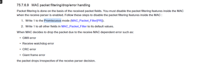

Hi @Changhawn,
You can set promiscuous mode by writing a 1 to MAC_Packet_Filter[PR]:
See chapter 76.17.4 (MAC_Packet_Filter) from the reference manual.
Also, promiscuous mode is set as
    GMAC_PKT_FILTER_PROMISCUOUS_MODE = GMAC_MAC_PACKET_FILTER_PR_MASK,               /*!< Passes all incoming packets irrespective of the destination or source address. */
In the Gmac_Ip_Types.h file from the RTD include directory.
Julián
