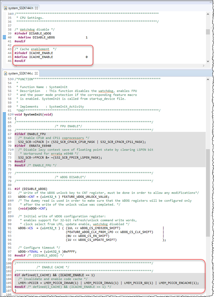

Hi hicense,
You can enable the Cache in SystemInit().
You can find some information in "3.3.1. CACHE" and "3.3.2. Speculative Flash reads" of AN12972 Optimizing the S32K1xx eDMA for Performance Demanding Applications.

hicensezhang
ok ,thank you
I open the cache as you describe,
I understand opening the cache can reduce the cpu access the memory and enhance the performance , I want to verify the performance between opening the cache and close the cache, can you have the way to verify the performance improved?
