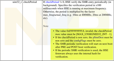

Hi @HyunungPark1
If checkPeriod is non-zero, some conditions must be met (copied from HSE Service API RM):
I can see that this is not considered in your code.
Also make sure that all the structures/variables used to communication with HSE are forced to non-cacheable area.
