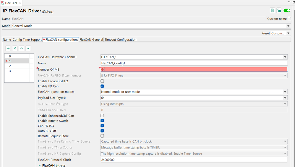

i am using s32ds rtd 4.0.0 and s32k344
i already completed to develope for using can-fd, when i set payload size is 8.
but can-fd is supported payload is 64 bytes.
so when i set payload is 64 bytes, and number of MB is 31, i got a error.
if i use payload is 64 bytes by can-fd, how much i set number of MB?
thanks.

in case of 64byte payload setting, the RAM block can hold up to 7 MBs.
As FlexCAN 1 has 2 RAM blocks (64MBs @8byte payload) then Number of MB configured can be 14 max.
BR, Petr
