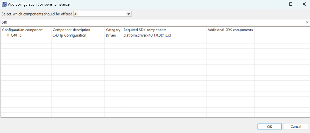

i gonna develope to bootloader by c40(low level driver)

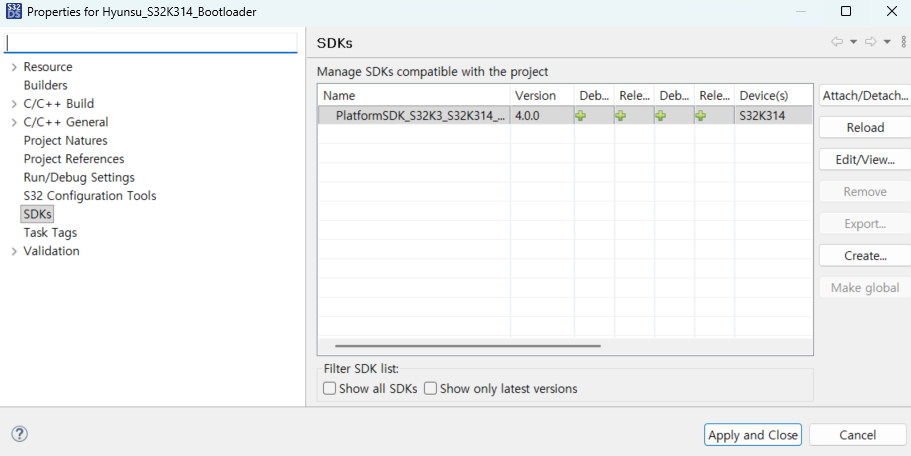

i am using s32ds version 3.6.1 and RTD 4.0.0 .
mcu is s32k314. and i wanna try to write to flash memoty for making bootloader.

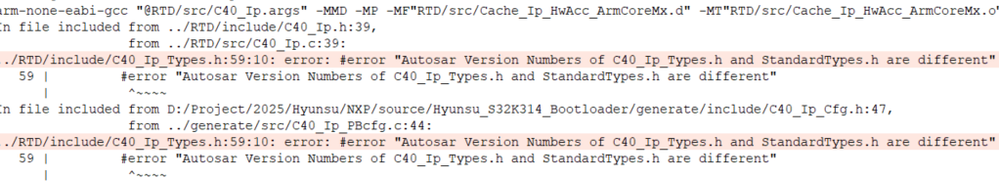

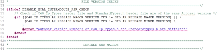

1. how do i fix error is related to write flash memory?
i install c40_IP and cache_IP.
Tags (3)

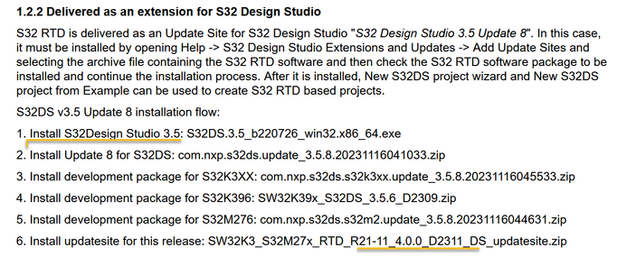

It looks like a compatibility issue.
According to RTD 4.0.0 release notes, the release has been developed and tested in S32DS 3.5 IDE.
To ensure compatibility, each S32DS installation should include only one compatible set of software.
  • Do not install multiple RTD releases within the same IDE.
  • If needed, you can maintain multiple separate S32DS installations.
