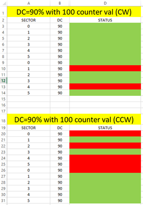

sarwath
Hello @marekmusak ,
With the help of hall sensor feedback I got the actual rotor position.
During start up, I gave duty cycle to 90 % once the motor start the duty cycle is controlled by the potentiometer. In few sector I am not getting the smooth start if I increase the POT value the motor is not rotating it is cogging then I deceased the POT value again I started increasing now it is rotating . what I understood is it taking time in few sector. I don't know the reason. I have attached my test result (CW and CCW). Please have a look and let me know your thoughts.
Note :  STATUS green for good start and red for bad start.
BR,
Sarwath

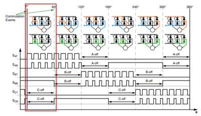

marekmusak
These two bit fields control OUTMASK and SWOCTRL of the Flextimer (FTM) in order to create complementary unipolar PWM (see AN12435 Figure 6).
Output Mask register (OUTMASK) provides a mask for corresponding FTM channel and Software Output Control register (SWOCTRL) actively force FTM channel to predefined value.
So for the 0 commutation sector we apply:
  • Mask 0x34 in hex format and 0011 0100 in binar format.
  • SW control 0x0808 in hex format and 1000 0000 1000 in binar format
So output of the FTM channels for 0 sector is:
  • FTM3_CH0  generates PWM
  • FTM3_CH1  generates PWM
  • FTM3_CH2  is masked (OFF)
  • FTM3_CH3 is actively controlled to high
  • FTM3_CH4 is masked (OFF)
See detailed description in application note AN12435.

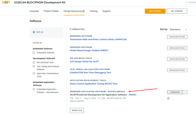

petervlna
I have asked kit owner to have a look at your query.
But meantime you can start with checking reference software, to find out where you did mistake.
https://www.nxp.com/design/development-boards/automotive-motor-control-solutions/arm-based-solutions...
Peter
