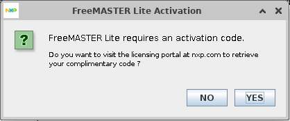

  1. During the installation, a pop up window should ask you whether you want to get a license:
    If you press "YES" it should redirect you to the corresponding URL (you just need to be logged on NXP.com).

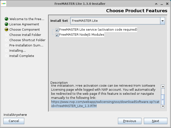

  2. You can also access the link manually. The URL can be found in the "Component selection" view in the description:
    Here's the link for version 1.3: license link.

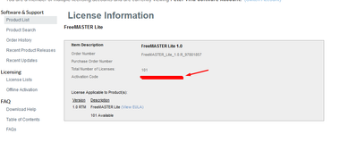

Ahelion
followed the steps, got a license for 1.0, but....

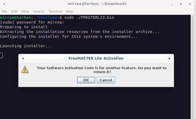

petervlna
Looks like your are using incorrect installation key, which is for another version.
Best would be to download installation again and along with correct license for that version directly from license tab like presented in installation guide.

Ahelion
i did follow the guide, it brought me to the license I tested and for which I posted above that the tool says it is not good. This is the name of the binary: FMASTERL13.bin, does it help?
