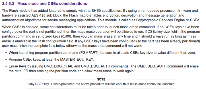

The FlexNVM memory is partitioned to EEPROM use and is blocked for some erase commands (Erase Sector and Erase Block). As a consequence, loading the program to flash memory may fail on some debuggers.
Please perform a mass erase operation on Flash to remove this partitioning after running the example to be able to update your application on target.

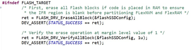

Actually, the code is issuing the erase all block command(mass erase) before partitioning the FlexNVM.
But after that instruction, the program is entering the default isr in startup.s file.
Can you please check with this?

I suggest that you carefully read the FLASH-related application manuals before performing practical operations.
AN12130:
