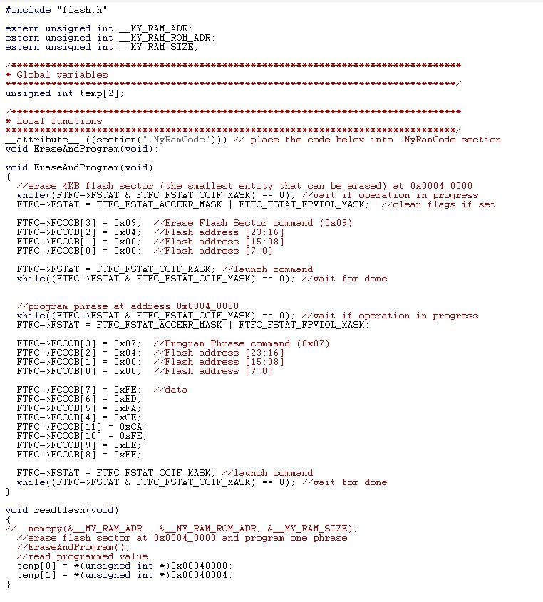

Hi,i'm debugging flash read an write,when i used "EraseAndProgram",single step is ok,but run at full speed ,it reset,would you help to find what the promble ,thanks! ps:  I  used external 5V to supply .

How did you define the .MyRamCode section?
Please try the default ram section using:
__attribute__ ((section(".code_ram")))   // place the function below into .code_ram section
void EraseAndProgram(void);
2,649 Views
shenlanzeng
thanks for your help,i tried it ,but it reset all the same

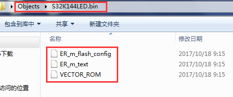

How to use MDK to generate bin,i used MDK generate bin like that:
but it generates a folder
can you tell me how to generate bin under MDK,thanks!
