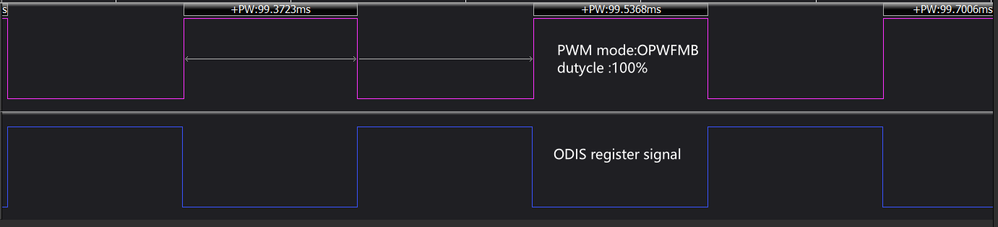

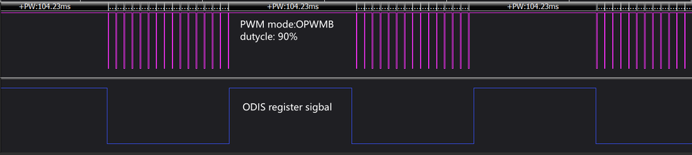

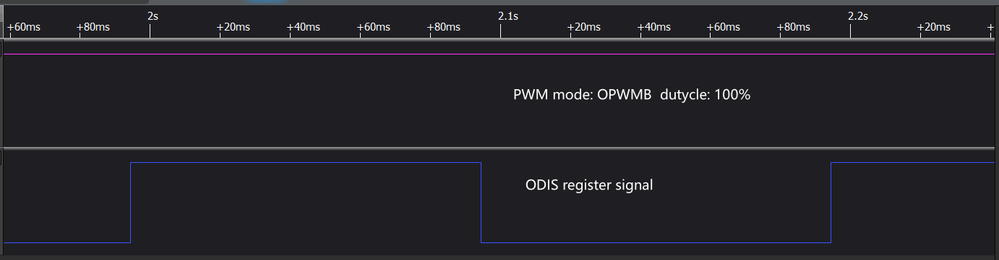

hello experts:
when (OPWMB mode)PWM dutycylce is 100%, it can not be output disabled by ODIS register.
But if the dutycycle <100%,the (OPWMB mode) PWM can be disabled output by ODIS register.Such as the dutycle is 99% the PWM(OPWMB mode) can be disable by ODIS register.
And if the PWM mode is OPWFMB,it can be disbled by ODIS when it's dutycle is 100%.
why?And have any method to solve?

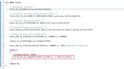

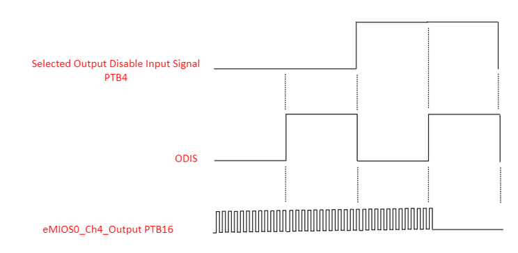

 I used the demo but not solved problem?
I toggled gpio_34 pin and connect gpio_34 with PTB4(TRGMUX_in,1).when the pwm dutycle is 50%.it can be disabled by ODIS.
when the pwm dutycle is 100%.it still can not be disable.
