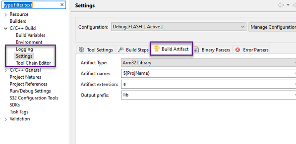

danielmartynek
Hi @semiconductor_user,
In the properties, the project can be changed from Executable to Library:
