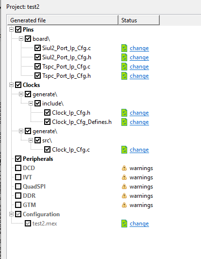

when I create a new project with S32K344, compilation work
but if i configure a pin and update code,compilation failed
directory platform install is \NXP\S32\S32DS\software\PlatformSDK_S32XX_4_0_0\RTD\Base_TS_T40D11M40I0R0
but message is
D:/NXP/S32/S32DS/software/PlatformSDK_S32K3/RTD/BaseNXP_TS_T40D34M40I0R0/include/OsIf_Internal.h:45:10: fatal error: OsIf_Cfg.h: No such file or directory
when I compile

to have more information, here the message when i select peripheral
my configuration is S32K344, why is not compatible ?

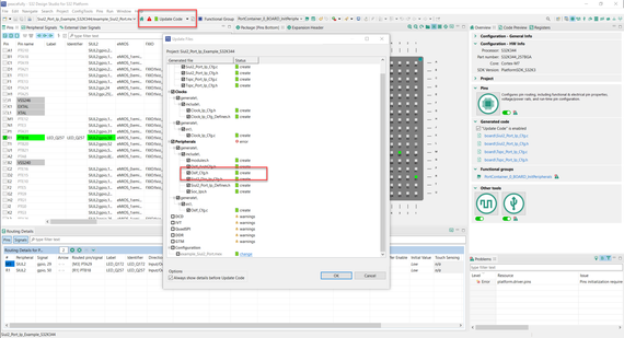

It seems you have not generated the OS code. Please check in the Peripheral setup, in OS>Generate you find Generate Configuration button. Press it and then update the code

i create a project with a guide_started_s32k_3xx and compilation is OK
but i tried to configure a pin and i have a error
D:/NXP/S32DS.3.5/S32DS/software/PlatformSDK_S32K3/RTD/BaseNXP_TS_T40D34M40I0R0/include/OsIf_Internal.h:45:10: fatal error: OsIf_Cfg.h: No such file or directory
i don't understand  why  this file is not inside my project
when i use the "manager SDK component"
i selected "OS" package and i have files related in OS in my project

spara7c5
Because you have not generated the OS. Press the generate button in peripheral>>OS>>general. And update the project

but i don't have peripheral , components view, and Osif configuration so i can't add this file
when i click on the peripherals tools,  it display  "The peripheral tool is enabled but it does not support the selected processor"
