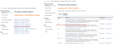

PetrS
in that thread you pointed to FreeRTOS compatible with RTD500, as Daniel wrote.
You need to use right version based on your RTD installed.
BR, Petr
196 Views
PetrS
download and install desired FreeRTOS package based on your RTD installed
https://www.nxp.com/webapp/swlicensing/sso/downloadSoftware.sp?catid=SW32K3-REFSW-D
Read release note document to be sure of right steps for package installation.
BR, Petr
