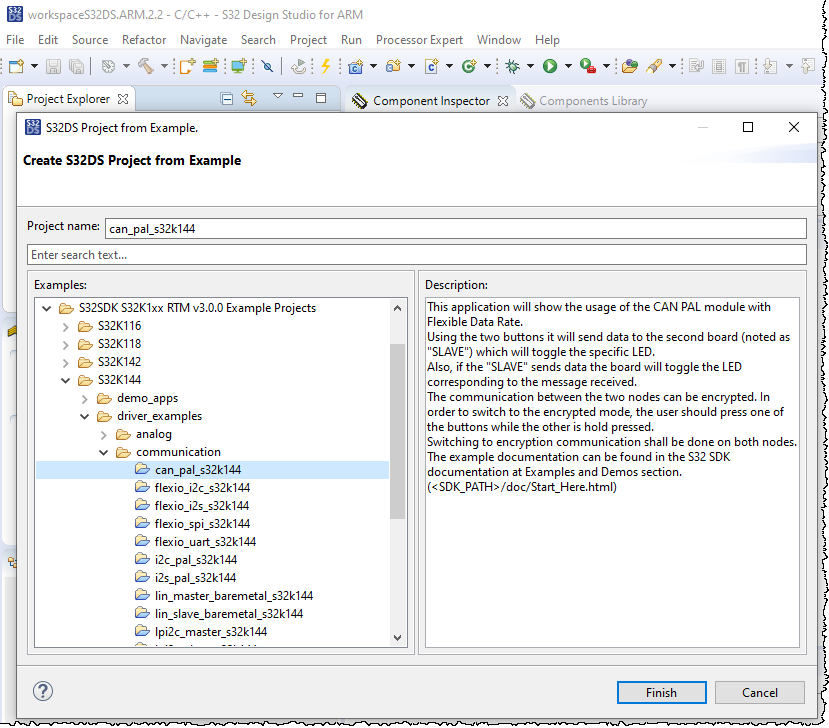

hello
i'm having trouble applying can FD on flexcan module with s32k1xx , can i get some example code with can FD to see what i'm doing wrong?
thanks in advance
タグ(1)
1 返信
1,495件の閲覧回数
Robin_Shen
Hi Ali Shaikh zada,

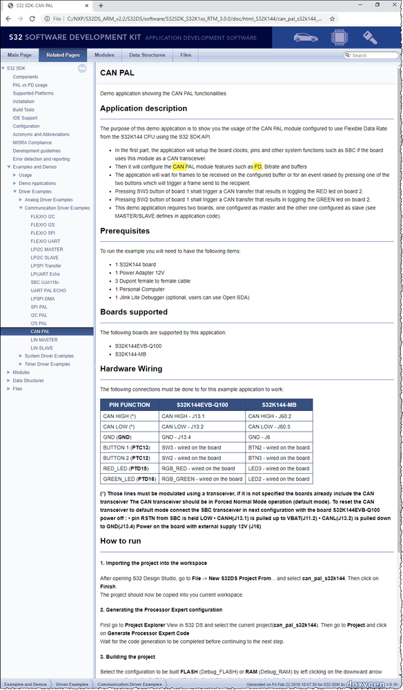

Please try to refer the CAN PAL example of RTM 3.0.0
This example shows how to use CAN FD communicate with another board.
