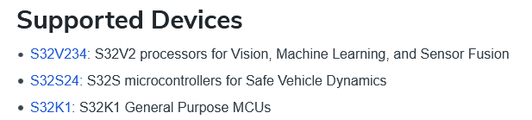

It seems S32DS 3.3 only support S32V234 and S32S24 as mentioned in the nxp website you gave.
2,641 Views
danielmartynek
I can see this on the website:
BR, Daniel
