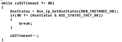

2. Once HSE firmware is installed, two things are needed:
- It's necessary to wait until HSE_STATUS_INIT_OK flag in FSR register in MU_0 is set. Before that, you can't trigger any HSE services. For example, you can find something like this in HSE DemoExamples:
Or something like this in RTD examples:
- When clocks are being initialized after reset, it's necessary to wait for WFI bit in PRTN0_CORE2_STAT register. This bit says that SBAF/HSE is in idle state and clocks can be changed. It's not possible to change the HSE_CLK while HSE is running, this can lead to unpredictable behavior. This was not done in earlier version of RTD drivers, it was up to user. Now it's fixed and implemented in clock init functions in RTD 5.0.0 and higher.

I’ve already tested my application firmware by waiting for the HSE to initialize, as shown in the image you sent, but it’s still not working. When I try to write to flash using:
C40_Ip_pFlashBaseAddress->DATA[0] = 0x00U;
542 Views

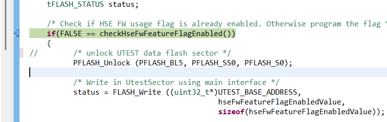

#hello @lukaszadrapa
I am working on the S32K3X4EVB-T172 board and trying to install the HSE firmware
The HSE firmware flashing is successful, but my application always stops at:
if (FALSE == checkHseFwFeatureFlagEnabled())
/* Stuck here */
So HSE FW initialization does not proceed.
I checked the UTEST region (0x1B000080), and I am getting the value 0XFFFFFFFF
please review our project and image and help us with this problem .
Thank u
