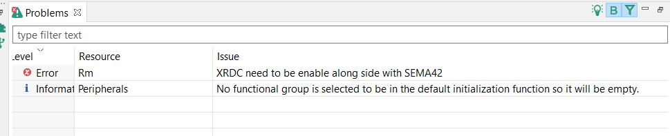

I'm using EB tresos with RTD 4.0.0 P20 D2403.
I don't find in  MCU => McuModeSettingConf=>McuPeripheral PRTN1_COFB0_CLKEN[REQ30] to enable the clock for the module ?
How can I enable the clock for XRDC ?
In the code when i call RM_init() I have got a hard fault in Xrdc_Ip_Init_Privileged()

It's on a S32K358.
after further tests, it's seems that it's because i don't configure XRDC memory domain correctly.
I only want to use SEMA42, and it's quite annoying because it's seems i must use XRDC that for now i don"t need.
There is another way to implement "spinlock" / atomic instruction on S32K358 ?

davidtosenovjan
No, it cannot be used separately. Trying to disable XRDC, having enabled SEMA42 lead in error.
