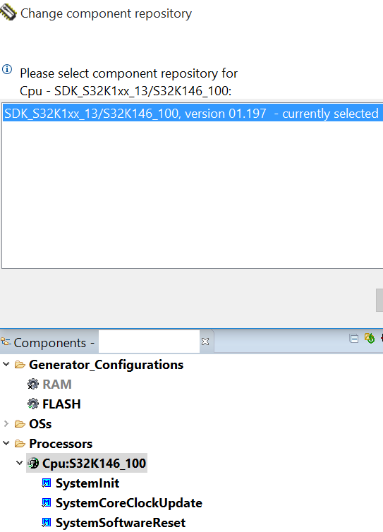

Hi Rares,
Thanks for the message. Indeed, I was expecting it to be generated depending on the platform. I can see that the macro is defined in the features header file as you mentioned. Despite of updating the repository for the processor, it looks that the new header files are not pulled from the new SDK when porting. Hence the project is using the old platform files. If this is not happening automatically when updating repository it would be nice to have a porting guide for all those necessary changes.

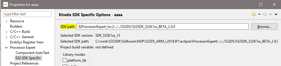

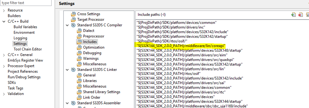

First, you need to go to Project Properties -> C / C++ Build -> Settings -> C Compiler -> Includes and remove all Preprocessor Include Paths starting with ${S32K146_SDK_<version>_PATH}.
Second, go to Project Properties -> Processor Expert -> S32 SDK Specific and update SDK path to point to BETA 2.9.0.
Click OK and then delete the contents of SDK and Generated Code folders.
Now it should work ok.
PS. Please refer to release notes for changes that are needed in the project to accommodate SDK changes.
Rares
