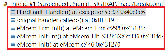

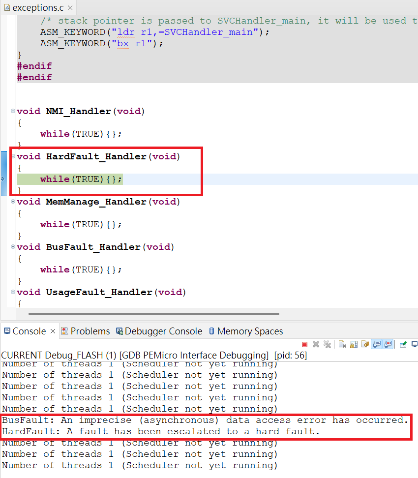

I want to add EMCEM to my current code, but after adding it, I found that it goes into the Hard Fault Handler. However, if I remove EMCEM, my code will return to a working state.

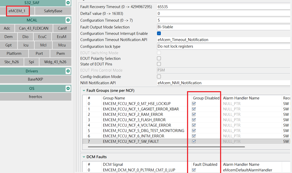

I tried turning off both Fault Groups and DCM Faults to see if the problem was caused by EMCEM's detection, but it still didn't work.

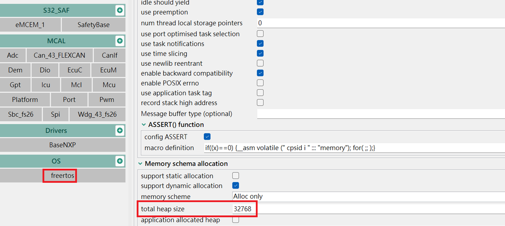

I tried adjusting FREERTOS's TOTAL HEAP SIZE = 32768, TIMER TASK STACK DEPTH = 2048, and QUEUE REGISTRY SIZE = 10, but it didn't work.

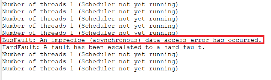

The message says "bus fault," but before I added the EMCEM module, all functions worked fine, and there was no bus fault. I don't know why it says this.

Hi @Allen_863,
Can you check in the MC_ME PRTN1_COFB0_STAT register whether the ERM clock is running or not before the eMCEM, ERM initialization?

Hi @Allen_863,
It appears that the fault occurs during ERM initialization. Could you verify whether the ERM clock is disabled?
If the clock is enabled, please provide additional details about the fault so we can investigate further.

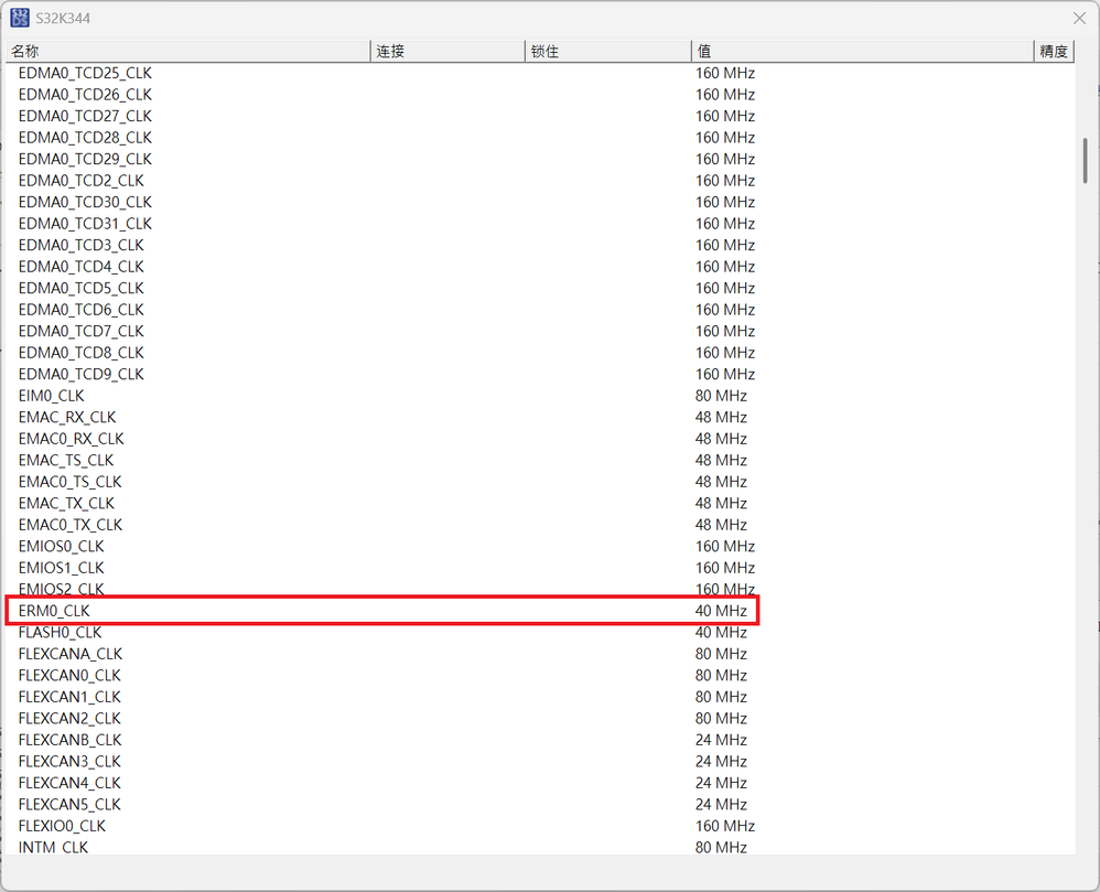

When configuring EMCEM, I didn't configure the clock. I only added the EMCEM module and added `eMcem_Init(&eMcem_Config_0)`. However, I checked the CLOCK configuration and it shows `ERM0_CLK = 40 MHz`. Is this correct?

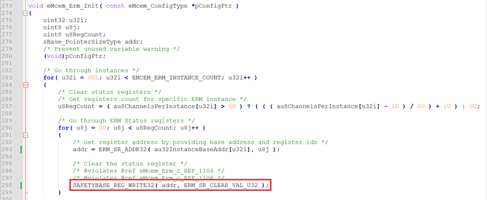

Then I found the problem was in the `SAFETYBASE_REG_WRITE32( addr, ERM_SR_CLEAR_VAL_U32 );` operation of `eMcem_Erm_Init`. If I commented `SAFETYBASE_REG_WRITE32( addr, ERM_SR_CLEAR_VAL_U32 );`, the `HARD FAULT HANDLER` error wouldn't occur. However, this is the RTD driver, and I don't think I should modify it.

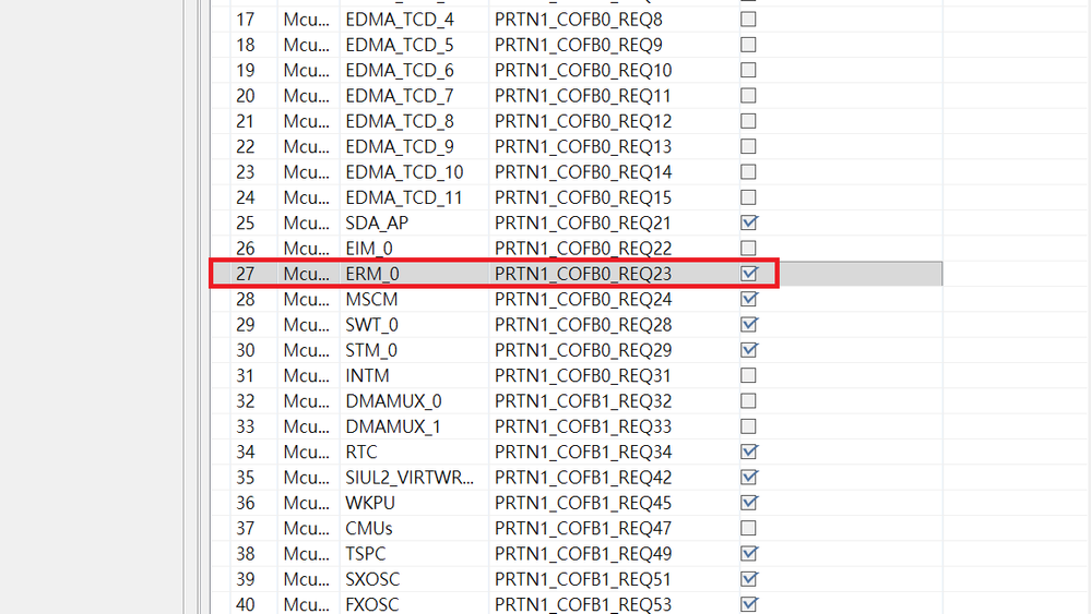

Allen_863
I checked bit 23 of MC_ME PRTN1_COFB0_STAT and found it to be 0. Then I found the switch for PRTN1_COFB0_REQ23.
Thank you for your help.
