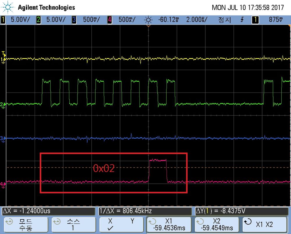

Hi. I have to change some parts of my question.
I found SPI's slave output was as below.
■ SPI's slave output is shifted to the left
   - with 1 clock(1bit)
   - only one time
   - whenever SPI starts first in interrupt
   - 1 is added to the last bit (farthest to the right )
   - from second frame, all frames are not shifted (1 frame is 8byte)
ex) original frame(8byte) : 0x01..., 0x82
      shifted frame(8byte) : 0x02..., 0x05
■ I have to send 0x01..., 0x82 first. How could I do it?

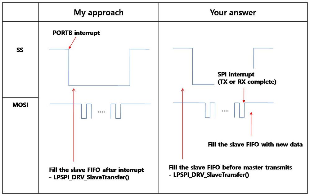

danielmartynek
The thing is, there is no interrupt when the transmission starts.
This is all handled automatically by the LPSPI hardware in the background.
When the master starts transmitting, it starts reading the slave FIFO. The data stored in the slave FIFO are being shifted out. The problem in your code is that the slave transmit FIFO is still empty. In fact, when the transmission starts, your code is making decision what to put into the FIFO which is late.
Only put the data into the FIFO using the LPSPI_DRV_SlaveTransfer() function and wait for the master. It will be transmitted automatically.
At the end of the transmission, an interrupt can be triggered and a new data can be prepared (put into the FIFO) for the next transmission.

kimjunghyun
Hi.
I updated some contents with my review results. So please consider below contents.
First, my goal is to transmit some frames of slave as below picture (2~3frame. 1frame is 8byte)
And I have to change frame values of slave based on conditions and send several frames
■ Question: Where should I put 'LPSPI_DRV_SlaveTransfer()' into the source code?

For you answer, I understood the problem : slave transmit FIFO is empty.
- The point is, When the master is transmitting, the slave buffer should be already written.
So I changed 'LPSPI_DRV_SlaveTransfer()' position to resolve my problem. (SPI slave's output is shifted to the left)
But the shift of first slave frame is not fixed. I think this problem and interrupt might be separate.

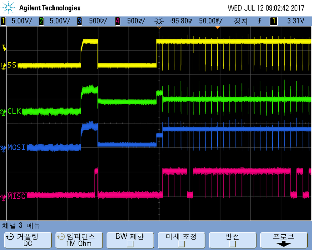

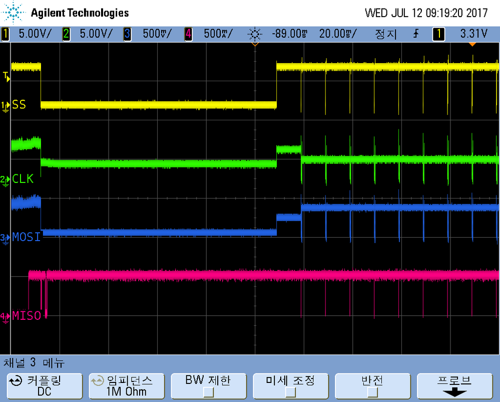

■ Test result based on position
1. In the main(), between 'LPSPI_DRV_SlaveInit' and for(;;).
  : Slave's frame is transmitted only one time. Although master transmits frames, slave does not response.
2. in the main(), inside for(;;)
  : slave transmits frames whenever master transmits frames. but slave's frame is different to defined variable.

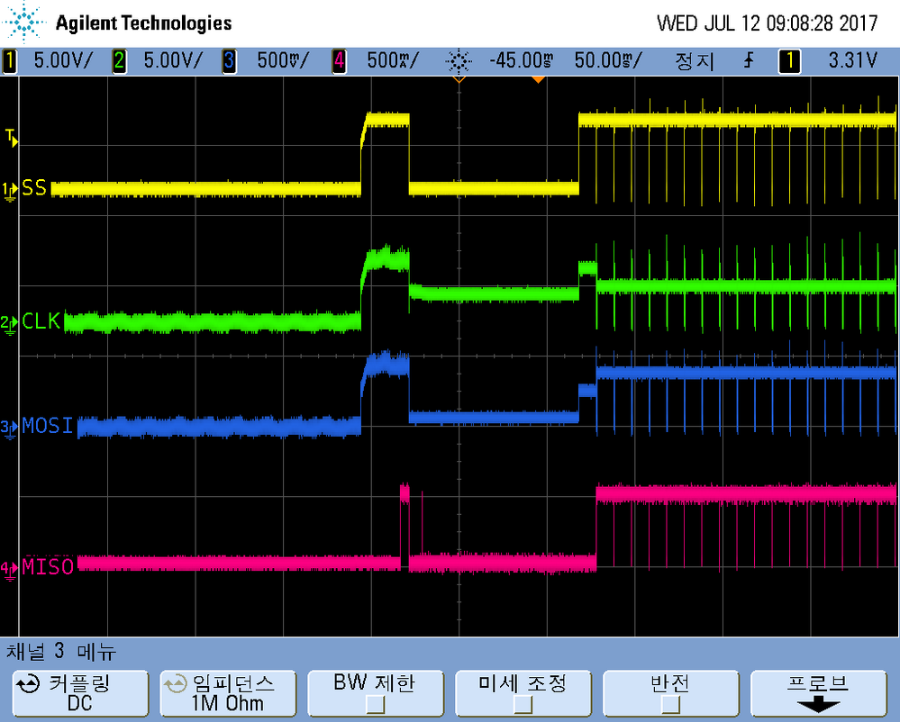

■ Difference based on 'LPSPI_DRV_SlaveTransfer()' position
1. in the main(), inside for(;;)
  : slave responses whenever master transmits frames. but slave' frame is different to defined variable.
2. outside main(), inside PORTB_ISR()
  : slave responses whenever master transmits frames. slave's frame is equal to defined variable. but only first frame is shifted to the left.
   * slave frame : {0x00,0x80,0x00,0x00,0x00,0x00,0x7e,0xc1}
  1) First frame : {0x01,0x00,0x00,0x00,0x00,0x00,0xfd,0x83}
      - first slave frame is shifted to the left and 1 is added to the last bit (farthest to the right)
  2) Second frame : {0x00,0x80,0x00,0x00,0x00,0x00,0x7e,0xc1};
       - after second frame, slave frame is not shifted.
■ my approach and your answer.
- for your answer, Where does SPI interrupt trigger in the source code? I have to know the code position and then I can put the slave frame value there.
Again, my question is as below.
■ Where should I put 'LPSPI_DRV_SlaveTransfer()' into the source code?
   or How can I fix the slave frame's shift to the left?
   or How can I change last bit(1, added to farthest to the right) to 0? (I have to send '0x01,0x00,0x00,0x00,0x00,0x00,0xfd,0x82' at the first slave frame)
Thank you.

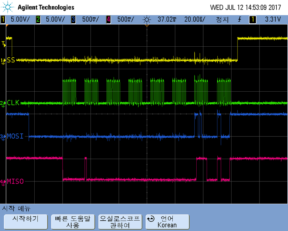

Ray_V
Contributor V
Referencing the first frame trace, dated "WED JUL 12 14:52:39 2017"
It seems your Master is at fault.
The CLK seems to Idle Low, but the master asserts SS while CLK is high. When SS gets asserted while clock is high the slave assumes this is the first edge and outputs the first bit. Then CLK goes Idle (Low) and slave "thinks" the bit was read. So when clocking starts data is off by one bit.
The master should have the CLK in the Idle state Before asserting SS.

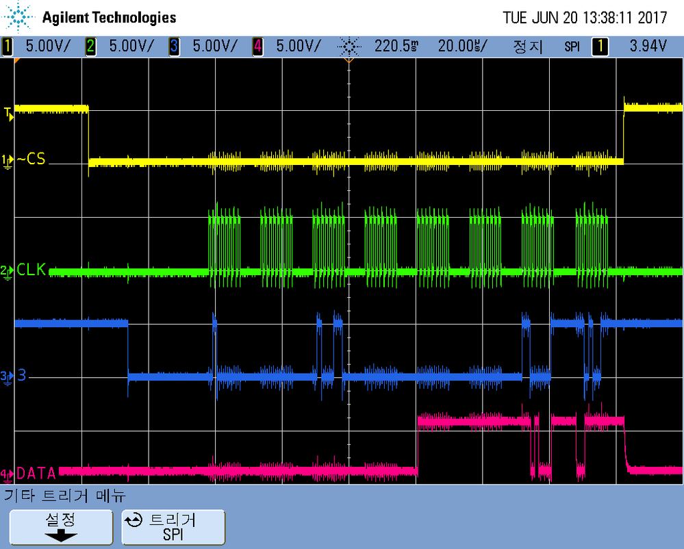

kimjunghyun
Hi. Raymundo Velarde
First thank you for your interest
I don't think Master is at fault.
Actually, Master connects to Hall IC(MLX 90363) which is a slave. When they communicates through SPI, Hall IC transmits a first frame without 1bit left shift and 1 added at last bit. They communicates correctly.
* Hall IC's first frame : 0x01, 0x00, 0x00, 0x00, 0x00, 0x00, 0xfd, 0x82
* 0x82 is 0b1000 0010 and it means that 1 is not added to last bit
And I made a slave with S32K144 as a Hall IC. When S32K144(slave) transmits a first frame, it is shifted to the left with 1 bit.
And what is 'assert'?
I do not know it's concept so I could not understand your answer exactly
Does 'assert' means output high or low?
Kim.

I forgot to add. You can't assume that if one slave behaves one way the others will.
One slave (HALL IC) may not shift first bit if SSEL is asserted with clock high while another might. This is hardware dependent.
In order for all slaves to behave properly you need to make sure the clock is idle when SSEL is asserted.

Ray_V
Contributor V
SS or SSEL is the Chip Select. It enables the chip that is to be read/written to. Assert means it is active(chip is selected). In your case (and in most cases) this means Low.
So the trace shows that 1 is added to the last bit.
For SPI to work correctly you must have Clock Idle -> SSEL asserted(low) -> frame(s) sent -> Clock Idle -> SSEL de-asserted(high).
Look at the second frame, clock is Idle (low) when SSEL is asserted and it transmits correctly.

danielmartynek
I think you should first read the reference manual, so that you can understand what it does.
To your last comment. When you put the transfer function before the infinite loop, the function will fill the FIFO only once, obviously. If you put the function in the infinite loop, the function will try to write the FIFO continuously. But the maximum number of words in the FIFO is 4 (8 bytes). Therefore, you must wait for the master. After the FIFO has been shifted out, it is empty and you can call the transfer function again.
You should use an interrupt. But not at the beginning of a transfer, as you did. All LPSPI interrupts are listed in Chapter 45.4.4. For instance, the interrupt can be triggered when the FIFO is empty. The problem is I don’t know how to do it using SDK right now. There should be implemented a callback function. Let me check it. This might take some time.
8,956 次查看
danielmartynek
The callback feature is available only in EAR 0.8.4 SDK version which will be released probably at the end of this month. Using older version of SDK, it is impossible to implement this feature.
I think the first byte is shifted because there is not enough time between SS assertion and the first CLK.
If the master is S32K144 as well, you can try changing PCSSCK in CCR register.
PCS to SCK Delay: Configures the delay in master mode from the PCS assertion to the first SCK edge. The delay is equal to (PCSSCK + 1) cycles of the LPSPI functional clock divided by the PRESCALE configuration, and the minimum delay is 1 cycle.
I don't think this is the case. Data is going one bit early, not one bit late.
Also, the transfer function can be in a loop. The FIFO level needs to be checked before writing and wait for next loop if FIFO is full.
8,956 次查看
kimjunghyun
I understood your answer
Not enough time between ss low and first clk causes the first byte is shifted.
But master is not S32K144 so I can not change this time.
- Master ; renesas mcu (maybe RH850)
- slave ; mlx 90363
And I have to make a slave with S32K144 for some test.
At this test, mlx 90363 is removed and S32K144 acts as a slave.
Do you have some other solution?

Hi. Daniel.
I did not understand your answer.
Relate to your answer
'there is no interrupt when the transmission starts. This is all handled automatically by the LPSPI hardware in the background'
'At the end of the transmission, an interrupt can be triggered and a new data can be prepared (put into the FIFO) for the next transmission.'
1. I should remove the interrupt code which I made.
[Source code]
  void PORTB_ISR(void) // PCS is input to PTB0 and PORTB generates interrupt for falling edge
   LPSPI_DRV_SlaveTransfer(RECEIVE,&slaveDataSend,slaveDataReceive,BUFFER_SIZE);
2. I should put the code to transmit the data of the slave FIFO in the interrupt code. I do not know where it is.
Where should I put the data of the slave FIFO in the code?
 1) Do you mean the position is above of the for(;;) in the main?
int main(void){
LPSPI_DRV_SlaveInit(RECEIVE,&ReceiveState,&Receive_SlaveConfig0);
LPSPI_DRV_SlaveTransfer(RECEIVE,&slaveDataSend_1_1,slaveDataReceive_1,BUFFER_SIZE);
for(;;)
 2) Or do you mean the position is inside while(1) in the main? (from LPSPI_Example)
int main(void){
LPSPI_DRV_MasterInit(SEND, &masterState, &Send_MasterConfig0); //  Is this code required for slave?
LPSPI_DRV_SlaveInit(RECEIVE, &slaveState, &Receive_SlaveConfig0);
while(1)
          LPSPI_DRV_SlaveTransfer(RECEIVE, &slaveDataSend, &slaveDataReceive, BUFFER_SIZE); // Is this interrupt?
          LPSPI_DRV_MasterTransferBlocking(SEND, &masterDataSend, &masterDataReceive, BUFFER_SIZE, TIMEOUT);
Thank you
Kim.
