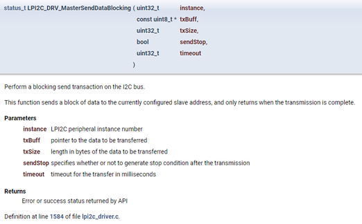

danielmartynek
Hi @wengzhaojie,
Please refer to the documentation of the driver.
The blocking transfer is completed when the function returns (with error or success status), there is nothing to abort.
LPI2C_DRV_MasterAbortTransferData() can be used for non-blocking transfers.
