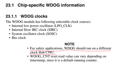

Why CMU should run on a different clock than WDOG?

The chip I use is S32K1xx. This is what the Reference Manual says:

PavelL
the reason is simple: if clock of CMU fails, the watchdog resets application (because is running on another clock) - assuming that CMU's reset is the safe state. Next actions depend on supervisor system.
If CMU and watchdog share the same clock, the application got stuck during clock malfunction.
Pavel
