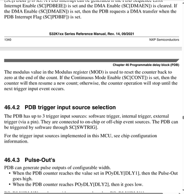

Where can we find the chip configuration information for NXP S32K1xx Microcontrollers

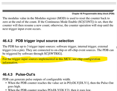

I want to know where can i finds chip specific details, for trigger inputs details which are mentioned:
I want to know about trigger inputs, for that on datasheet it is written that find information on chip configuration details. Where can i find that???

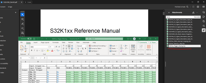

Senlent
Hi@gkunalupta
S32K1xx_Trigger_Muxing.xlsx can be found in S32K-RM's attachments.

Senlent
Hi@gkunalupta
PDB is an internal module of the chip, and it has no external pins connected to it directly.
PDB needs to be connected to external pins through the TRGMUX module.
In the previous answer, I have told you the location of S32K1xx_Trigger_Muxing.xlsx
