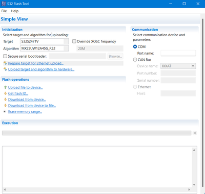

Hello NXP team.
I've stumbled across this flash tool
... and I would like to know if there is any tool used for S32K344 in and if possible to have a GUI.
1. Is there any GUI flash tool for S32K344 ?
2. Which HW / SW do you suggest for production / debugging of S32K344 mcu ?
Kind regards,
kyf.
973 Views
davidtosenovjan
1) This tool does not support S32K devices.
2) Along with recommendations from our website below you could also take a look on third party providers’ website:
https://www.segger.com
http://www.lauterbach.com
http://www.pemicro.com
https://www.pls-mc.com
Also I could point out to some other solution of production programming (direct programming of MCU over ZIF socket):
https://www.elnec.com
