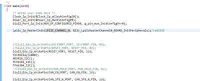

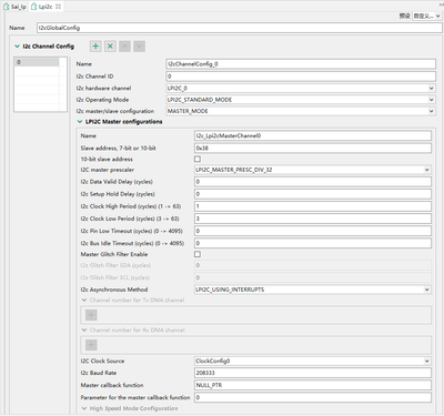

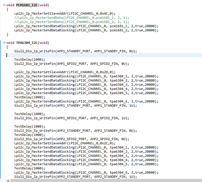

When i use multlink unversal, the i2c can't work.
But when I use jlink or run it directly in flash, i2c can work properly.
Can u help me?
