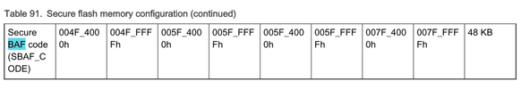

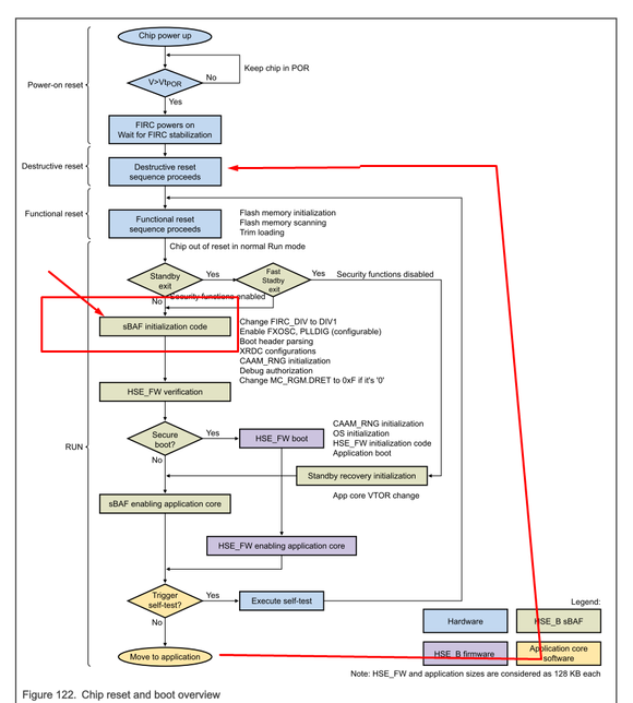

hello,
 When a Destructive Reset occurs, where does it move to the address value in s32k31x?
is it Boot header address?
816 Views
petervlna
You will end up in sBAF as Reference manual explains:
So 0x4F_4000 or 0x5F_4000
