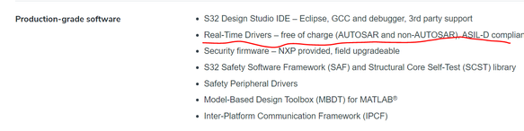

Hi@ZhaozhangChen
1.Autosar 4.4 are supported.
2.Currently supports Autosar 4.4 only.(I didn't find any description about the R19-11 version)
3.The license of S32K3 is free, but you need to apply for it on our webpage before using it.
2,301 Views
ZhaozhangChen
Do you mean that S32K3 can use Autosar for free?Is Autosar free for S32K3?
2,295 Views
Senlent
yes, you can get those informations vir our webpage.
