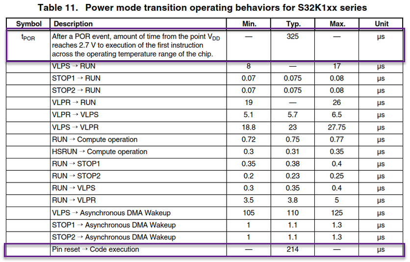

What is the time for the S32K1's power supply to rise to the RESET pin?

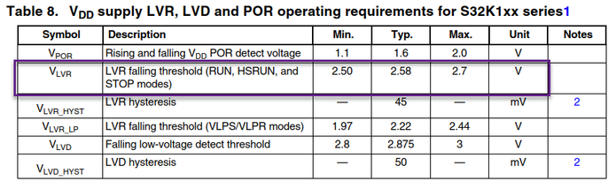

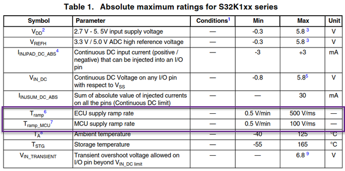

Hi @jingfang,
It depends on the power supply ramp rate:
Once VDDX reaches 2.7V, which is the Low Voltage Reset Deassert threashold, the MCU leaves the system reset.
In the datasheet, you can find these specifications:
