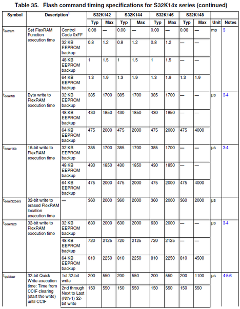

What is the erasing time of eeprom in s32k1?

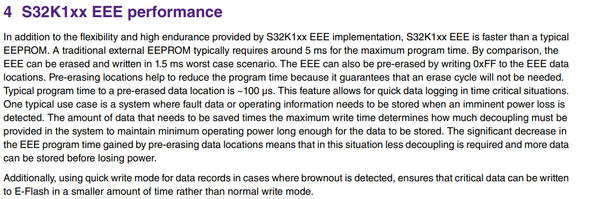

Hi@jingfang
There is no separate description describing the EEPROM erase time.
I hope the information in these two files below is helpful to you.
1.AN11983 Chapter 4 S32K1xx EEE performance.
https://www.nxp.com/search?keyword=AN11983&start=0
2.S32 DS
