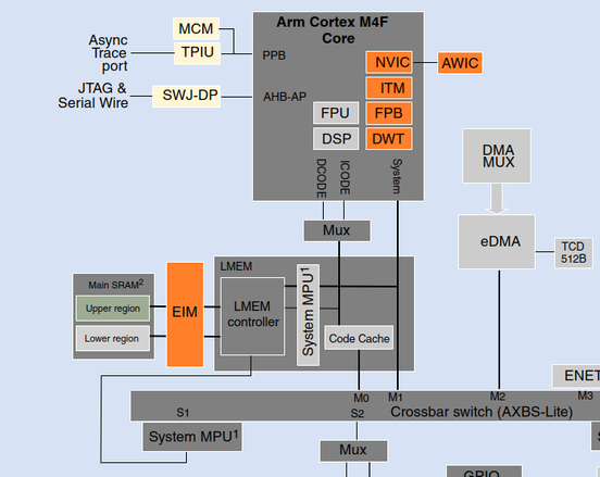

S32K142_FLASH_ID
/* SRAM_L */
m_data (RW) : ORIGIN = 0x1FFFC000, LENGTH = 0x00004000
/* SRAM_U */
m_data_2 (RW) : ORIGIN = 0x20000000, LENGTH = 0x00003000
What is the difference between the two? Is it possible to remove part of the memory allocated by SRAM_L to SRAM_U?
365 Views
danielmartynek
Hello @Eden_0,

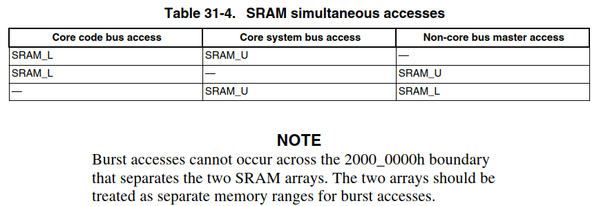

These are physical SRAM memories.
SRAM_L is connected to the core code bus whereas SRAM_U is connected to core system bus
RM, Section 31.3.2 SRAM accessibility
RM, Figure 2-1. S32K14x and S32K14xW product series block diagram

Eden_0
Thank you  for your support,
352 Views
danielmartynek
Please find S32K1xx_Memory_Map.xlsx attached to the RM.
The SRAM_L and SRAM_U are physical memories with defined address regions.
In the linker file, the memory allocation in that regions si up to the user.
