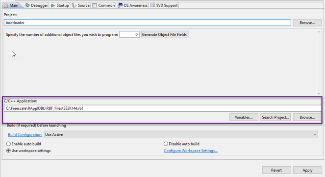

Hi @danielmartynek
Probably a stupid question but how do I get the .rbf into s19 format?
Thanks!
2,189 次查看
danielmartynek
Hi @Poley,
Sorry for the confusion.
It is in S19 format and it can be loaded like this from the S32DS.
Instead of PE Micro OpenSDA you can use PE Micro Multilink.

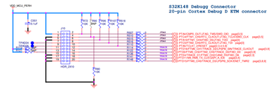

So as long as my design has the same JTAG pinout to the dev board (Will just copy it fully so it works the same):
Then I should be able to flash my .rbf using a JTAG tool in S32DS?
Thanks for the help!

danielmartynek
Yes, that is correct,
I tested it with a PE Micro Multilink probe on S32K144 EVB.
